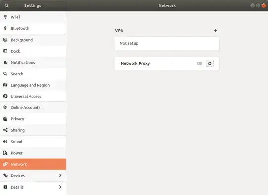

UPDATE: Before turning off the computer, I turned off the cable connection in Settings. Today when I turned it on, the ethernet button is gone: enter image description here

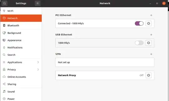

I arrived at this question while getting the same message in the title from an Ubuntu 20.04 PC after connecting a GigE vision camera to our ethernet network via a USB adapter.
This added a second Ethernet connection point but it awas disabled by default, as shown in the picture:
USB Ethernet connection by default
After enabling it through the Settings UI, I re-installed the network-manager as suggested by dschinn1001, and the error went away:
