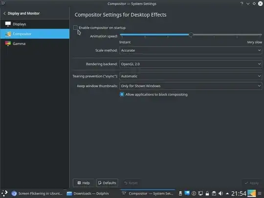

I just deactivate the compositor from settings/GUI. I'm new to Linux and stuff but this work for me, I'm using Kubuntu on a very old system/pc.
as seen in the picture
