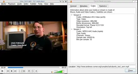

  2. vlc: Downloaded from the Bionic Beaver Repository does not support AV1 files. This support could be compiled in from vlc version 3.0 and greater. See screenshot below...

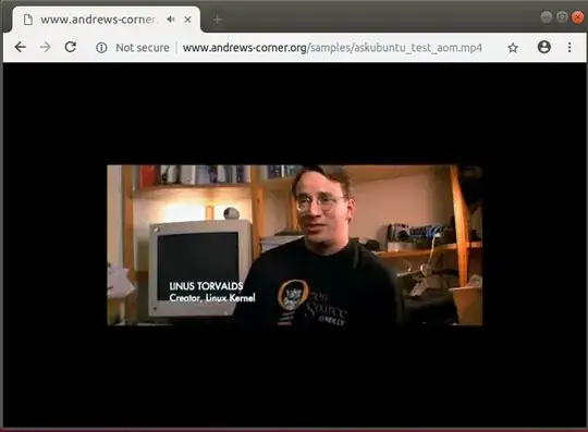

  6. Chrome: Again 2 points here:
    1. Chrome is not available from the Bionic Beaver Repositories.
    2. The -dev version of Chrome had no problems with playing the sample file. I tested Version 70.0.3510.0 (Official Build) dev (64-bit). Available as a direct download from Google, see screenshot below!

Chrome!! For doing it all with the least fuss :)

Vlc!! For getting it all done, just waiting for the packagers to catch up :).
