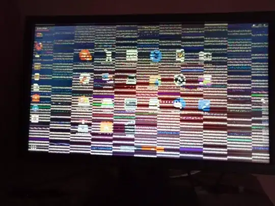

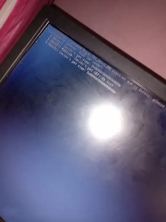

I'm getting this when I click on Try Ubuntu or when installing ubuntu. it's uefi bios. my pc have intel pentium g3240. I tried mbr and gpt but still getting this. Edit: it was happening with every linux distro and today I tried Android x86 with no hardware acceleration and it booted and fine. So please tell me if there's no hardware acceleration in Ubuntu.

it seems your system has trouble with video driver you can try xorg open-source driver by typing this in terminal(may not work with try ubuntu as it does not have persistent storage)
sudo apt-get install xserver-xorg-video-intel
