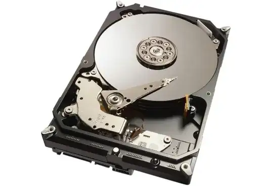

Disk platters:
Disk platters
  • Professional dust-free room repair only, sorry!
OR

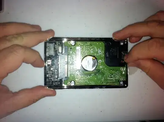

Disk controller:
Controller Board
  • Buy an identical second-hand working one on e-Bay
  • Remove its controller board
  • Remove your HDD
  • Add the "new" controller board
  • Reinsert repaired HDD

Disk platters:
  • Ticking noises before it gave up completely
  • Higher pitched tone before it gave up
  • Doesn't spin up, but gets extremely hot
