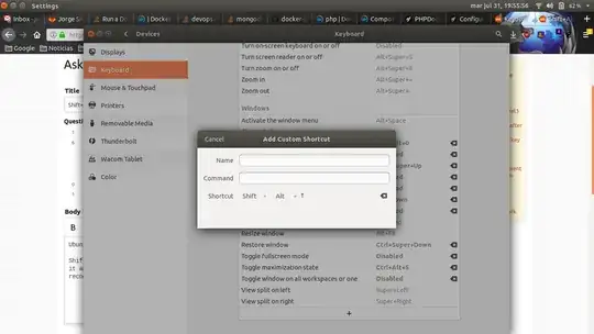

Shift Alt Down does not work in PHPStorm. Also, I can't assign any shortcut to it and it is not recognized as a shortcut (but top, left, and right do get recognized.
I use PHPStorm and cannot do a Move Line Down because of this.

EDI: I have reinstalled the OS (18.04.1) just to ensure it wasn't a problem with updating. BUT I kept my home folder. It doesn't work either. But my Gnome extensions are there, so maybe there is a config directory for it in my home folder? Previous to reinstall, I renamed the folders gconf, gnome and compiz in the home folder.

It doesn't work because most probably Alt + Shift switches input language for you and it doesn't let PHPStorm use that shortcut. Bad bad gnome.
