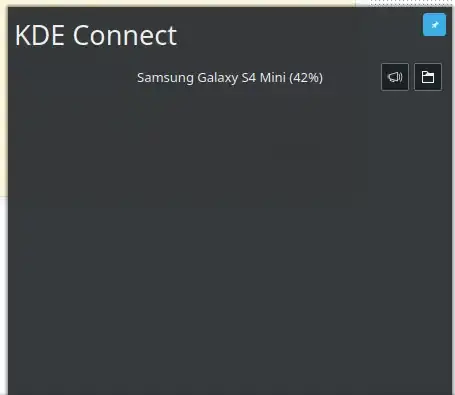

I set up KDE Connect on Kubuntu 18.04. Ping and the File Explorer are working fine from the desktop. I am able to recieve, read and respond to SMS. However, I have no clue how I can send an SMS, when I try to start the process from the desktop:

Click on the applet in the top-right of your screen on Ubuntu. You’ll see the options that are available with KDE Connect. One of them allows you to send a text message. Select that and a Compose SMS window will appear.
There are two boxes: One for the number of the recipient and one for the message. Compose the text message, and send it. Note that kde connect and Ubuntu just pass the message to your phone, which does all the work.

It's confusing because there are two indicators with kde-connect
One only appeared after I enabled SMS on both PC & phone and then sent an SMS to myself
Two indicators
One of the indicators has Send SMS and the other doesnt
