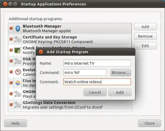

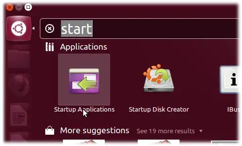

  • Search for "Startup Applications" from the Launcher enter image description here
  • Click on add. Paste the path in the command textbox. You can provide any name, comment. enter image description here
  • Click on "Add" at the bottom and the snap will be added to your startup applications.
