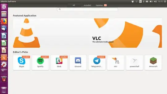

I see that more people have asked this question without reply.
I have tried to reinstall the software-center, but without luck. anybody ever managed to fix this problem? i really like browsing for software..
this is how it looks:
it is something that's been around now for some months..
thanks in advance :*
