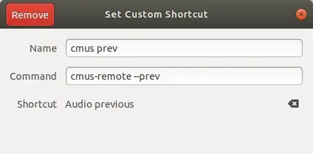

cmus has remote-commands that you can assign in your keyboard shortcuts config
cmus-remote --pause   #Play/Pause
cmus-remote --next    #Next song
cmus-remote --prev    #Previous song
cmus-remote --stop    #Stop
cmus-remote --seek -5 #Rewind 5 seconds
cmus-remote --seek +5 #Forward 5 seconds
E.g

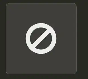

I only have one problem left.
Every time I press the Audio Play key from my headphones, Ubuntu shows the notification below and the shortcut is not executed, but if I wait the notification to disappear and press it again, it works.
