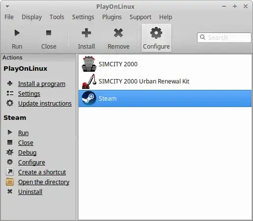

After that is installed and configured, then run your PlayOnLinux and configure your Steam:

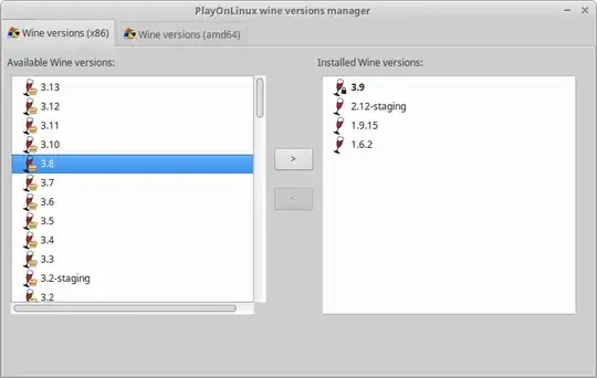

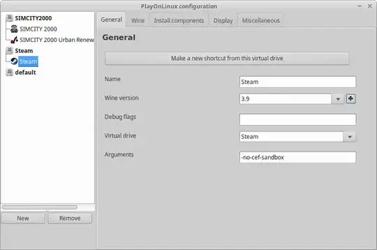

Configure General settings. I had to add 3.9 to mine. You can try different versions to see what works for you):
To add the 3.9 click the + on the right of the Wine version box and choose 3.9 on the left side then click the > to add it to the right:

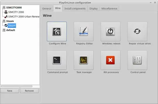

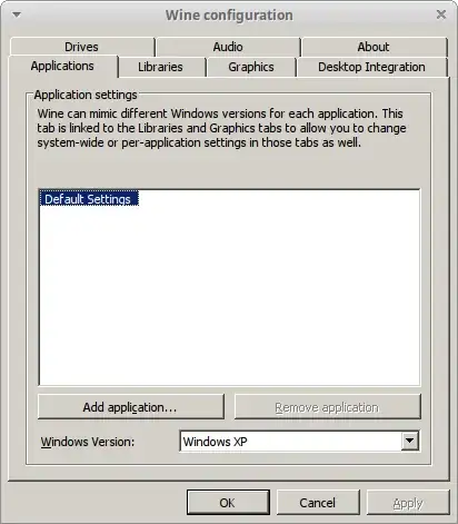

Click on Configure wine to set it to Windows XP:

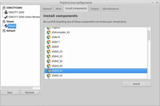

Click on the Install Components tab and install the following listed below the image:
d3dx9_42
vcrun2008
xact
vcrun2015  (if not available choose vcrun2013)

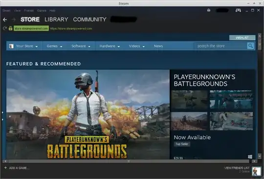

When complete, launch your Steam:
