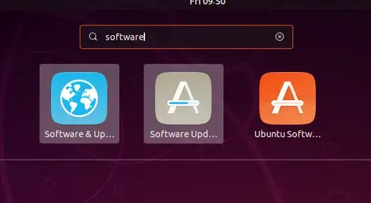

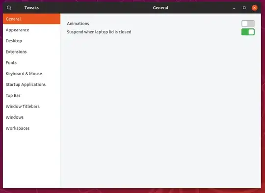

You could try to turn off animations. In your Dash write search for software and open Software Updater. Under Ubuntu Software turn on universe repository and click Reload. After that, install Gnome Tweak Tool with:
sudo apt-get install gnome-tweak-tool
In the Tweak Tool search for Animations and turn it off.
