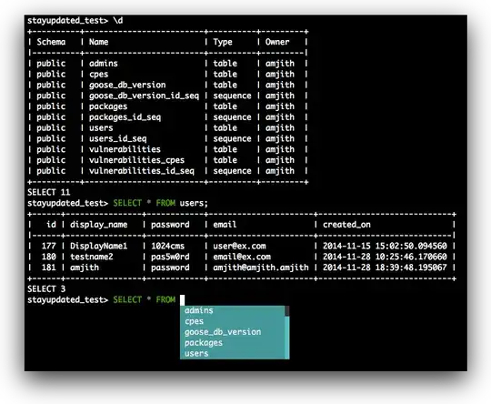

You can issue commands from the terminal, but you can get an open source package with tab completion, colours, etc:

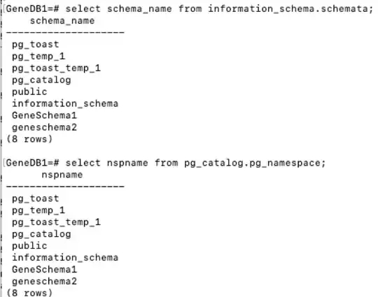

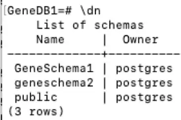

You're getting that error message because you forgot to include the Schema in you SELECT * FROM dbname; query.
You shouldn't be using \d, you should use \dt with the Schema name (not DB name). for example \dt "MySchema".*

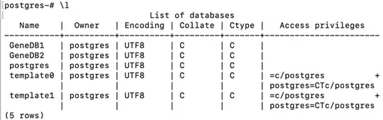

Here's how to connect and see your DB, Schemas, and Tables:
*) Type "\?" for help
*) Type "\conninfo" to see which user you are connected as.
*) Type "\l" to see the list of Databases.
*) Connect to a database by "\c ", for example "\c GeneDB1"
You should see the key prompt change to the new DB, like so: enter image description here
*) Now that you're in a given DB, you want to know the Schemas for that DB. The best command to do this is "\dn".
Other commands that also work (but not as good) are "select schema_name from information_schema.schemata;" and "select nspname from pg_catalog.pg_namespace;":

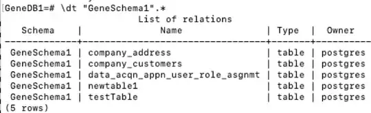

-) Now that you have the Schemas, you want to know the tables in those Schemas. For that, you can use the "dt" command. For example "\dt "GeneSchema1".*"
*) Now you can do your queries. For example:
