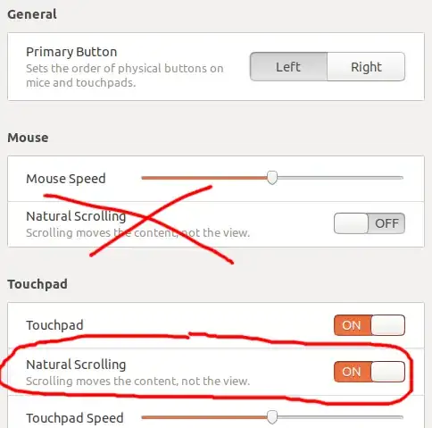

So after re-installing the Synaptics driver I took another look at my settings and now I feel really stupid. I figured it out.
I don't recall there being separate options in 16.04 for "mouse" and "touchpad", or if there were then I properly set my mouse up so long ago, that when I updated to 18.04 (and it reverted my touchpad settings) I had completely forgotten.
Toggling the appropriate setting worked as expected
