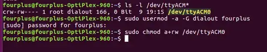

In combination with all the posts I read, this is what I did to solve that issue by following directions from this thread.
In a new terminal, I typed the following as shown below.
https://i.sstatic.net/ifRmx.png
Please note that fourplus is my username.
