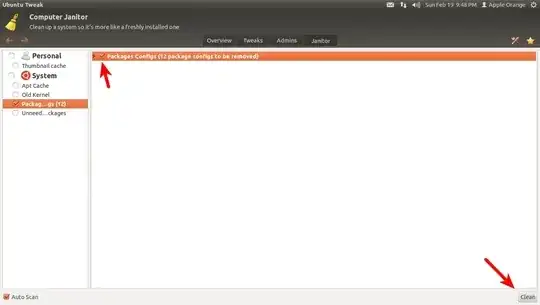

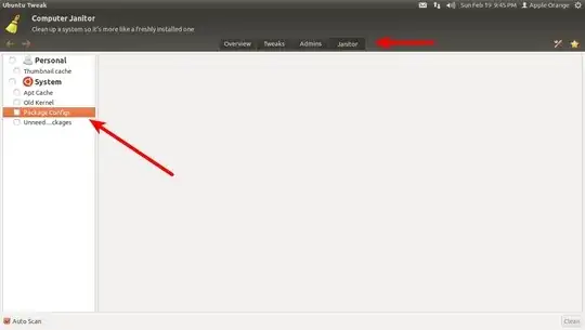

Ubuntu Tweak 0.6.x series has introduced some new features like: Unity-specific settings and tweaks,   a built-in Computer Janitor   , options to change the theme, icons, fonts and more.
To install the latest Ubuntu Tweak 0.6, use the commands below:
sudo add-apt-repository ppa:tualatrix/ppa
sudo apt-get update
sudo apt-get install ubuntu-tweak
Or download it from Launchpad.
Ubuntu Tweak
Ubuntu Tweak
