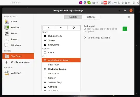

You could try
  • Install app-indicator using sudo apt install budgie-indicator-applet
  • Logout/Login
  • Launch budgie desktop settings from terminal:
    $ budgie-desktop-settings
    This settings manager is inside of budgie-desktop package. You could find all related packages by invoking a command:
    $ apt-cache search budgie-desktop
  • Add applet go to Top Panel section, click the Add applet 'plus' button and choose what you need.
    Bugie Desktop Settings applet adding to panel picture
If that did not help, you could also try
  • sudo apt install libappindicator-dev as someone already suggested
  • Log out and Log in again to see if you have this applet available in Budgie Desktop Settings
