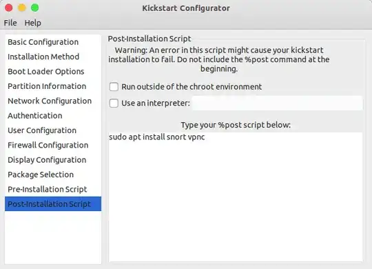

  • Config installer
    The kickstarter should open. Enter your configuration, user/root, partitions, etc.On the %post section you can add your apt install commands.
Save your config file.
(note the sudo infront of the apt command is an error! use apt without sudo)
