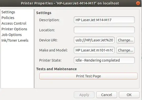

I'm trying to get my printer to work on 18.04LTS.
I have both an old laserjet 1018 and a new laserjet pro M15a. Neither are working, the 1018 was working under 12.04TLS. The printers are recognised but the jobs stay in the queue in a "stopped" status. From now on I will only talk about the new printer, which is the focus of my question.
Google here and there and now I'm trying to follow these instructions from HPLIP on launchpad.net.

I tried the usual re-installing, power cycling, cleanup etc and now I'm at a dead end. I even changed the USB cable, nothing works.
NOTE: The printer is actually auto-recognised as a different version, and even the name is not the same as the one I have. My version is not present in the list of available drivers, but the one I have is the reccomended option. See image attached.
Can anyone point me in the right direction?
