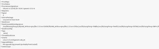

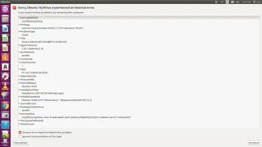

More detail from the non working version. 4.13.0-45 works. I'm also getting a system error but it seem unrelated. See pics.enter image description hereenter image description here
