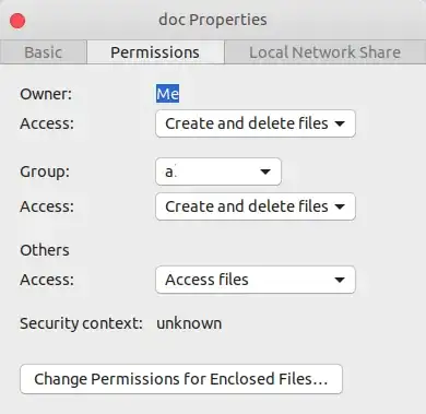

Using a gui based file browser
You can also use a file browser to change file permissions.
For instance on a gnome desktop open nautilus, right-click on a directory/file and change to the permissions tab. You will see a window like the one below. You can now change the permissions for others by clicking on the others-access list.
