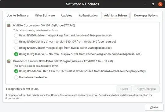

I recently installed a fresh installation of Ubuntu, and downloaded some Nvidia drivers via nvidia-driver-390. I noticed that nvidia-340 was also installed (as a "binary driver" instead of a "driver metapackage"). Interesting. Later, I installed nvidia-driver-396. I'd like to remove versions 340 and 390, so I can only use 396. I have used sudo apt remove --purge nvidia-340 nvidia-390 and also uninstalled some of the related packages (nvidia-common, nvidia-current, nvidia-settings, nvidia-prime, nvidia-kernel-common*, etc.) At this point, I'm just trying to remove every trace of Nvidia drivers from my system and start fresh. Unfortunately, in the included "Software and Updates", drivers 340, 390, and 396 are still listed. A screenshot is attached. Thanks for your help.enter image description here

ubuntu-drivers devices:
== /sys/devices/pci0000:00/0000:00:01.0/0000:01:00.0 ==
modalias : pci:v000010DEd00001382sv000010DEsd00001065bc03sc00i00
vendor   : NVIDIA Corporation
model    : GM107 [GeForce GTX 745]
driver   : nvidia-340 - third-party free
driver   : nvidia-driver-390 - third-party free
driver   : nvidia-driver-396 - third-party free recommended
driver   : xserver-xorg-video-nouveau - distro free builtin
== /sys/devices/pci0000:00/0000:00:1c.7/0000:04:00.0 ==
modalias : pci:v000014E4d00004365sv00001028sd00000016bc02sc80i00
vendor   : Broadcom Limited
model    : BCM43142 802.11b/g/n (Wireless 1704 802.11n + BT 4.0)
driver   : bcmwl-kernel-source - distro non-free
Note: The second one is my wireless card, the first one is my graphics card that this is about.
ubuntu-drivers list:
nvidia-driver-390
nvidia-340
nvidia-driver-396
bcmwl-kernel-source
Note: Again, the first three are the ones I want to remove, and the last is for my wireless card.
Eate
  • 421
17
Pay your attention to ubuntu-drivers devices command output - there are following lines:
The lines mean you can use nvidia 340, 390, 396 drivers from third-party repository and open-source nouveau driver from distro repository. Only one driver is recommended to you. The list doesn't mean all of the mentioned drivers has been installed in your system. It indicates only potential possibility to install the drivers. The list can't be changed manually as being formed with ubuntu-drivers utility designed to automate proprietary drivers detecting, inspecting and installing from available to Ubuntu repositories.
Thus, to change the list it's necessary to remove third-party repository, which is proprietary GPU drivers repo in the particular case. But it's highly unrecommended to do, since your goal is to keep nvidia 396 driver anyway and remove from automatically created list nvidia 340 and 390 drivers. If you remove the third-party repository, only distro drivers will be detected as available, which will be in the particular case only 340 and 390 - thus, you'll obtain most undesired for you situation.
My suggestion for you is to do nothing. Your system looks healthy, everything works well.
