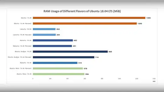

I have collected information about the comparative RAM and disk usage of Ubuntu, Lubuntu, Xubuntu and Kubuntu from watching this YouTube video.

Ubuntu MATE is the equivalent of Xubuntu in lightweight system requirements, but it is better than either Lubuntu or Xubuntu because MATE desktop environment has true HiDPI support in 18.04 and later. Every aspect of Ubuntu MATE 18.04, its themes, its applications, its icons and its toolkit assets have been updated to take advantage of HiDPI. This is a great feature for web development.

It might be difficult to know the answer without testing.
  • You can 'Try' them live or persistent live booted from a fast USB 3 pendrive or USB 3 connected SSD (without touching the internal drive).
  • You can do the same or similar test with installed systems in the same kind of external drive(s).
    After such tests you will know, what works best for you, with the tools that you want to use. It might also be good to have several flavours in a multiboot environment to test what is developed in your favourite desktop environment.
  • I should also say that there are four light-weight Ubuntu family flavours,
    • Lubuntu - ultra light
    • Ubuntu Budgie - medium light
    • Ubuntu MATE - medium light
    • Xubuntu - medium light
      All of these flavours are light enough for your computer. I would say that it should work well also with standard Ubuntu and Kubuntu, even though their desktop environments need more 'horsepower' and RAM to work well compared to the light ones.
  • I suggest that you use versions with long time support, LTS. The most recent one is 18.04 LTS (the LTS versions are released in April during even years, so 14.04, 16.04, 18.04 ...). Standard Ubuntu and Ubuntu Server are supported for 5 years, and the community flavours for 3 years.
    The other Ubuntu family versions are released in April odd years and in October every year. They are supported for 9 months, a very short time.

I've been using Xubuntu for the last 8-9 years for web development and i'm happy with it. Low on resources and the stock software is simple but pretty solid. It can be customized to be pleasant to the eye, for example with Numix Theme.
I will recommend you upgrading to at least 8gb of ram, it's not strictly necessary, but it will make your life easier, specially if you plan to use VMs and/or Docker. Also, it's the cheapeast upgrade that you can make with a big improvement in performance. A sdd drive for the boot & root partition (even a small one) is also a nice adittion, using your current drive as secondary in a caddy. That's my setup.
As people pointed out, go for a LTS release. That will let you keep your custom setup at least for 2 years with security support.
