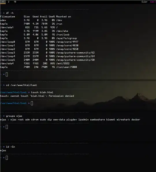

I'm running Ubuntu 16.04.4 LTS and facing a problem. All of a sudden I'm unable to edit files that I could before, I cannot run programs due to permission errors.
I'm always logged in as a user ejaz belonging to primary group ejaz and secondary groups root adm cdrom sudo dip www-data plugdev lpadmin sambashare kismet wireshark docker. I have several websites in sub-directories of /var/www/html/ (not in ~/public_html because it is a dev machine with no security/sharing considerations). Taking a website, /var/www/html/test, for example; it belongs to user:group www-data:www-data. Me, logged in as ejaz, am getting permission errors while editing files in test directory. I seem to have correct group permissions to edit this directory.
Output of groups command
~ » groups ejaz
ejaz : ejaz root adm cdrom sudo dip www-data plugdev lpadmin sambashare kismet wireshark docker
Permissons for test site
/var/www/html » l | grep test
drwxrwxr-x  2 www-data www-data 4.0K Apr  9  2017 test
But any editing results in permission errors
/var/www/html » cd test
/var/www/html/test » l
total 16K
drwxrwxr-x  2 www-data www-data 4.0K Apr  9  2017 .
drwxrwxr-x 87 www-data www-data 4.0K Jul 10 06:50 ..
-rw-rw-r--  1 www-data www-data    0 Apr  9  2017 blah.html
-rw-rw-r--  1 www-data www-data   16 Apr  9  2017 .htaccess
-rw-rw-r--  1 www-data www-data   73 Apr  9  2017 index1.html
/var/www/html/test » touch blah.html
touch: cannot touch 'blah.html': Permission denied
Output of id command
/var/www/html/test » id -Gn
ejaz
which is understandable since ejaz is the primary group.
But If I su as ejaz, I'm able to edit the file in terminal and in any program that is launched from that particular terminal instance
Question
Why am I not able to edit the files all of a sudden and how was I able to edit those files before? All I did since yesterday was to run Ubuntu's apt upgrade.
Any help will be greatly appreciated.
Thanks for reading.

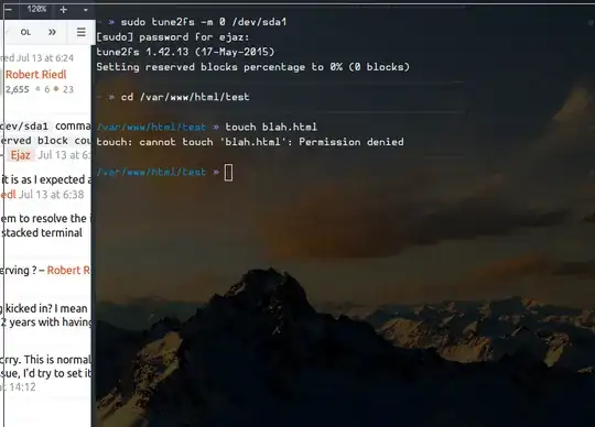

reducing reserved blocks to 0 didn't help

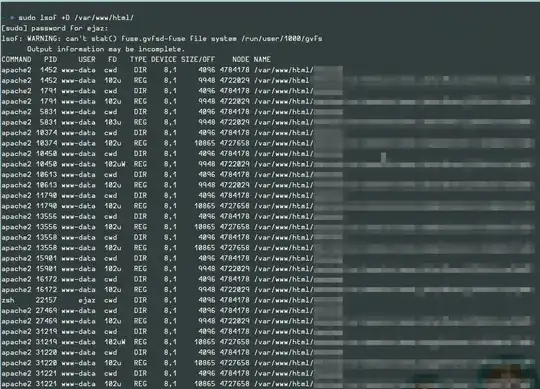

The blurred out text is of following pattern..
/var/www/html/magento_site_1
/var/www/html/magento_site_1/var/session/sess_xxxxxxxxxxxxxxxxxxxxxxxxxx
with xxxxxxxxxxxxxxxxxxxxxxxxxx being a random string. The screenshot is complete output.

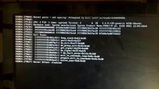

I left my computer turned on overnight to download some files in /mnt/SSD2 on the single SSD my computer has, and came back to this in the morning
Upon rebooting I got a busybox initramfs command prompt where running fsck /dev/sda1/ allowed me to use my PC again, but is this connected to permissions issues I'm having? Is my SSD dying? Is it the newly installed kernel which was installed using sudo apt upgrade shortly before the permissions issue started occurring?
