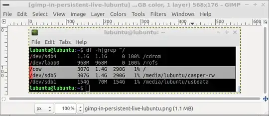

I can verify that gimp can be installed and that it works in a persistent live Ubuntu 18.04 LTS [family flavour, Lubuntu].
My test system was installed into an old hard disk drive, that I have connected via a USB3 to SATA adapter. I used mkusb to create the persistent live system.
I have run gimp also in standard Ubuntu 18.04 LTS and it works also in a USB pendrive, if there is enough free space in the casper-rw file or partition. You must activate the repository 'universe' for the gimp package to be found and installed,
