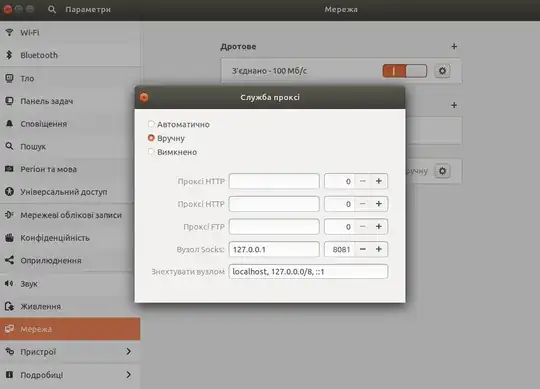

Add this settings as Ubuntu system-wide proxy settings and instruct browsers, bash etc. to use system proxy. It's possible to add system proxy with Ubuntu System Settings GUI (mine has Ukrainian locale): enter image description here
If you want to use the proxy for apt, read Configure proxy for APT?, only take into account you have socks-proxy, thus the proxy URLs should be socks4://127.0.0.1:8081 or socks5://127.0.0.1:8081 instead of http://127.0.0.1:8081, for example:
