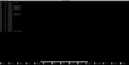

Step 1: check what is allowed to wake up your system:
Open a terminal:
sudo nano /proc/acpi/wakeup
Step 2: understand the results:
Screenshot of /proc/acpi/wakeup content - step 1
The list shows what device can awake your computer.
Here: EHC1 - EHC2 - XHC
Step 3: Block the device that wake up your computer:
Disable EHC1 in your terminal with:
echo EHC1 | sudo tee /proc/acpi/wakeup
Suspend your computer. If it still awakes, try
echo EHC2 | sudo tee /proc/acpi/wakeup
Note: EHC2 instead of EHC1. You can also try with XHC)
Note: above command is a kind of toggle. If you use it 2 times in a row, it will turn off EHC1, then turn it back on

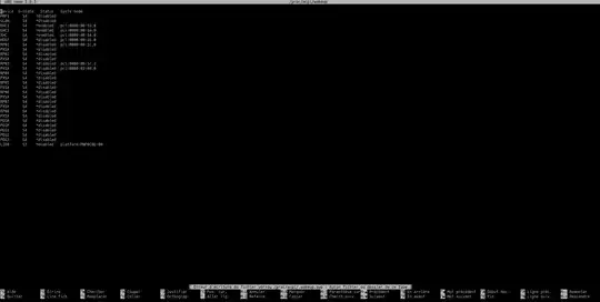

Step 4: Confirm it worked
Here, it was EHC2 that woke up my computer (my USB wifi dongle). Now, it's disabled, it cannot awake my computer, and it stays suspended.
