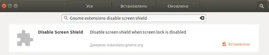

Open Ubuntu Software Center, click search sign at the right upper corner of the window and type in the search field "Gnome extensions disable screen shield" phrase. You'll see the "Disable Screen Shield" Gnome shell extension. enter image description here Install the extension and voila - the curtain has disappeared.
