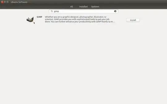

Install by GUI
Open Ubuntu Software and search for gimp:

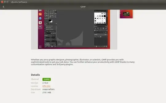

Now click on the description of Gimp to expand it, and scroll to the bottom.
Note, the gimp version number and developer. If satisfied, click on Install and provide the your password when prompted.
One thing is about snap packages is that they are rather large. This is because they are self contained, and have all the dependencies stored inside the package. Each snap app runs in its own sandbox.
Snap apps will automatically update to the latest build as soon as the developed makes the updated snap package available. So, even if it says gimp 10.0.0 now, it will get updated when the the latest version becomes available in this format.
