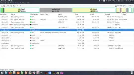

I have a 1 TB hard disk with Windows 8.1 and Ubuntu 16.04 LTS installed (dual booted). When I open GParted, this is what it looks like for me:
I want to increase the size of my /home (/dev/sda/11) directory using the unallocated space of 234 GiB (the one before /dev/sda6). How exactly do I accomplish this? Do I need to take a backup of my 320 GiB (/dev/sda6) partition as well (in case a live CD or USB is needed)? I tried reading the solutions given at the following link but couldn't quite understand how to go about it.

Recommended to always backup important data before moving partitions.
The good news is, this does not move the boot partition causing your system not to boot. You will have to do this from a LiveCD as you need to unmount all the partitions that have a key icon on them before you can move them.
You would need to move sda6, sda9, sda10 and sda11 in that order to the free space in front of them. Then you should be able to resize sda11 to the remaining space.
