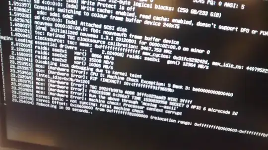

My ubuntu system (Ubuntu 18.04 Server) keeps crashing. The error is above. It shows up different every time. I have a Core-i7 2600K. Does anybody know why? Can I add more detail here? I feel like I can, I don't know how.

My problem turned out to be that ASUS's "Optimized Defaults" were just garbage, causing my Core i7-2600K, with a max Turbo Speed of 3.8 GHZ to try to turbo all the way to 4.3 GHZ, therefore causing the cpu to stop working, then the computer shutdown and rebooted repeatedly. When I discovered this, switching through the BIOS, I turned it off and as far as I can tell, it works now. I ran a stress test overnight and its still on this morning with a max temp of 60C.
