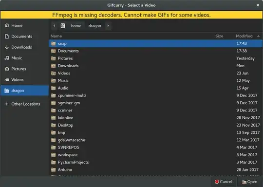

I'm trying to use gifcurry on Ubuntu 16.04 but I get the following warning which will not allow me to select my mp4 I created in KdenLive.
I installed gifcurry as instructed on the site. It opens up fine.
I also tried installing libav-tools but I still get this yellow error or warning which will not allow me to open my MP4.
Does anyone know how to install the proper decoders so I can open my mp4 file? Is there anyway to simply install a whole lot of them which will probably cover it for my mp4?
