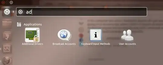

  • Open the dash and look for the Additional Drivers tool

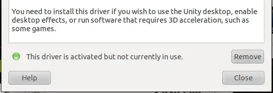

  • Select the Nvidia driver currently in use, it should have a green mark on it and once you select it the button on the right bottom corner will say remove, press remove and let Jokey do it's magic
