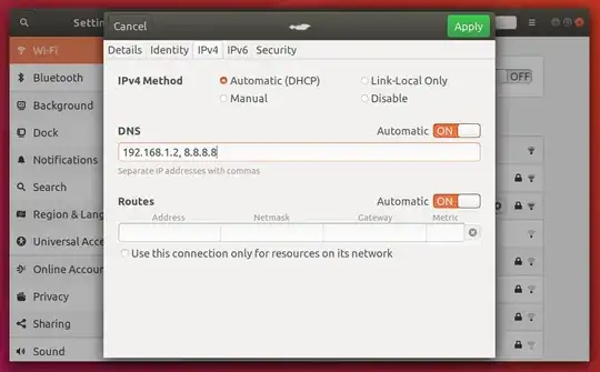

I was mostly satisfied with WinEunuuchs2Unix' solution but somehow it was still failing sometimes for whatever reason so I had to restart the network very often, often 4 times during the same sitting at my company desk.
I finally ended up setting my WiFi connection to always use both DNS addresses:
It probably results in slower connection sometimes, but at least I can connect to the company website reliably.
