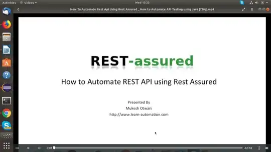

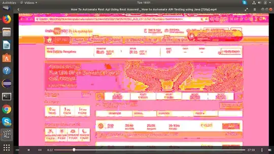

Try with this command,
sudo apt remove gstreamer1.0-vaapi
I faced same problem with videos displayed in distorted manner. After this the video displayed is now with better quality.
Screenshot of earlier how it displayed: Screenshot of later how it displayed:
