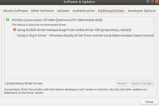

  • NVIDIA proprietary drivers in use as per the following image:
