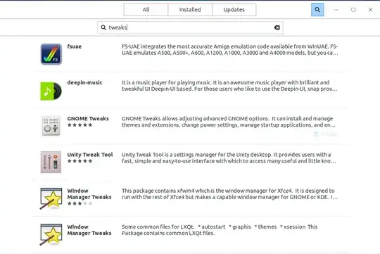

Installing Gnome Tweaks from Ubuntu Store; from the store, search for tweaks. See attached screenshot.
Ubuntu Store
