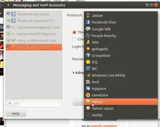

First you have some alternatives to Yahoo messenger. For example, the Empathy messenger that comes with Ubuntu:
but assuming you want the actual Yahoo Messenger, the Yahoo Messenger running with Wine does not work (tested myself right now) and the Linux version for it is very old and gave me a weird error. For the time being, you can use the alternative like Empathy, Pidgin and any other messenger that supports the Yahoo protocol. All of which come with Ubuntu or can be found in the Ubuntu Software Center.

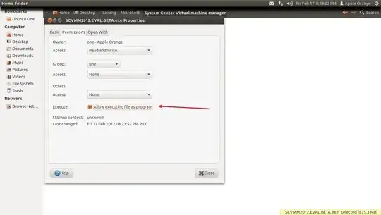

Instructions
  1. Install Wine . Wine is what is known as a "transition layer," which is a fancy way of saying that it is a program capable of running Windows programs . It is a bit like an emulator. Installation files for Wine can be obtained by selecting "Ubuntu Software Center"
  2. Download the Yahoo! Messenger installer as normal. This is an executable file with a .exe file extension that contains all the files and instructions necessary to install the program on your machine. On the Yahoo! Messenger webpage select the "Download" tab near the top of the page, and then select "Download Now" from the page that loads. Save the file to your Desktop for easy access for the next step.
  3. Execute the Yahoo! Messenger .exe file. If Wine has been properly installed, Ubuntu will automatically load the setup.exe file within Wine, which will cause the normal program setup dialog boxes to appear with instructions to follow just as if you were installing within Windows.
Right Click > properties > Permission > check Allow executing programs
4 . double click it & install it
