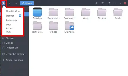

There are not an easy solution to that problematic. I need to explain some things as a meta-anwser to realy be possible underestand what happens and where it's the rigth place to ask about all this features you notice are gone.
In recently versions of Gtk (Gtk+3) was added a new feature called appmenu. This feature can be used instead/as an option, of the normal and standard feature called menubar.
Appmenu:
Appmenu
Menubar:
Menubar
The appmenu is more realated with options of the whole application (quit, about..), than options related with this specific window where the menu is set, while the menubar cover both type of actions, the application actions and the window actions(copy, paste, ...). Because of that reason, the menubar is a bit more general then and also ofcourse is more big than the appmenu. Then the menubar is more difficult to be acomodate in interfaces desinged for litle screens like in a phone.
Please note that a copy and paste actions are window specifics, because you are copying some selected files from one window to another. So, it's not the type of application actions and then they are not part of the appmenu actions, but they can be part of the menubar actions.
After that point and like exist both features, the menubar and the appmenu, the developer of the especific application is who need to deside if he want to show one or both types of menu and what type will be selected.
While most of external gnome developers want that his applications will be compatible with other desktop enviroments like KDE, they select the menubar way as is the standard. Instead, the gnome developers select the appmenu, as this is his own way and they concidered it better. This not mean necesary that if you select one or the another way, the rest will not exist ever more. Just will not be show as default.
