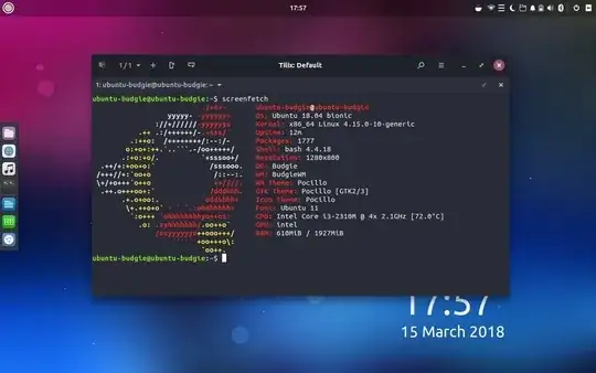

I don't want to install the Budgie Desktop Environment to avoid bugs and endless tweaks. Specifically, I like the Transparent Top Panel and the Icon pack. Is there a Budgie theme for Gnome?
