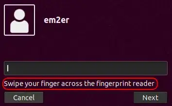

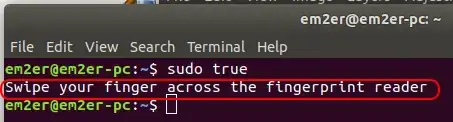

I've just configured Elan's fingerprint device on my Xiaomi Notebook Pro under Ubuntu 18.04 with latest upgrades. Official version of libfprint which coming with Ubuntu is not supporting Elan's device, so I use to build iafilatov's version. Maybe it can be useful for HP 2530 by changing vendor ID according to lsusb's output following this manual.
In my case fingerprint-gui crashes on successful verification with iafilatov's libfprint, so I am using fprintd utilities only
  • Install fprintd and enable it for sudo
    sudo apt install -y fprintd libpam-fprintd
    sudo pam-auth-update
  • Update libfprint building and installing iafilatov's libfprint. See README.md for build release version.
  • Update symbolic link /usr/lib/libfprint.so.0 -> /usr/local/lib/libfprint.so.0.0.0 (to the newly installed iafilatov's build.
  • Allow fingerprint enrolling to user as follows:
    1. Create /lib/udev/rules.d/40-libfprint0-custom.rules as follows:
      ATTRS{idVendor}=="04f3", ATTRS{idProduct}=="0c1a", MODE="0664", GROUP="plugdev"
      Vendor & product IDs can be found in lsusb output, search for Elan line smth like Bus 001 Device 005: ID 04f3:0c1a Elan Microelectronics Corp.
    2. Add your $USER to plugdev group:
      usermod -a -G plugdev $USER
    3. Reboot
  • Enroll fingerprints:
    fprintd-enroll
  • Verify fingerprint matching
    fprintd-verify
  • Done. You can check it by calling sudo or while Ubuntu session login (may need reboot): enter image description here enter image description here
