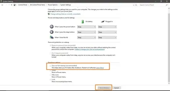

Windows has hybrid shutdown and then, Ubuntu can not wrtie to NTFS.
A real full shutdown of Windows allows the ntfs partitions to be mounted with R/W perms by Ubuntu.
For a full shutdown of windows, hold the SHIFT key as you press the "Shut down" button. You may also disable the 'fast startup' feature in the Windows power control panel.
