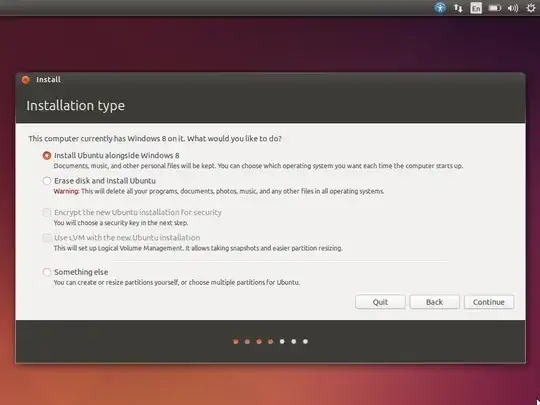

ubuntu windows dual boot option
What I am trying to say that above option is not showing but all the rest options from second onwards is showing. The laptop that I am using is Lenovo g5080. I have Windows 10 (64bit) already installed and I don't want my data to be erased. Why am I unable to dual boot Windows 10 with Ubuntu 18.04?

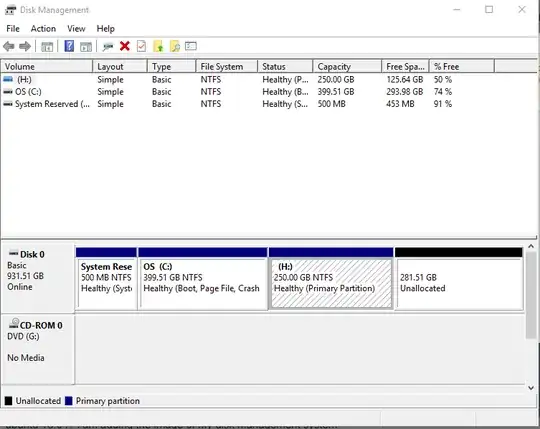

disk management system

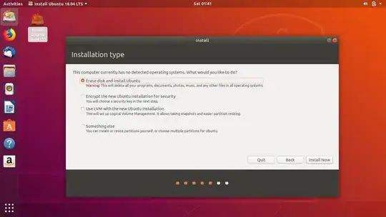

I am also adding screenshots from Ubuntu installation pages. I don't see "install Ubuntu along with Windows" option as shown below :

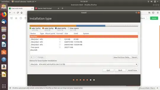

and partitions in Ubuntu. the free space is what I intend to use for Ubuntu installation

I finally figured out all the problems related to my system and was able to dual boot ubuntu alongside windows 10 without any data loss. In these kind of problems the issue is different for different persons depending upon the hardware and type of firmware they have. I will write down the problems and solutions that i specifically faced for future reference. So, if anyone encounters similar problems they can check the following:
  1. Check what is the type of your disk in the disk management system in windows. There are two types of them: basic and dynamic. To dual boot as it turns out it should be basic. In my case i had dynamic types originally. To convert it to basic type without any data loss i used aomei dynamic disk converter software. That seems to be the only possible solution in my knowledge.
  2. Although the dual booting can be done in old legacy boot mode but in my case i tried many ways to do that but was unsuccesful all the time. So the better option is to change the boot mode to uefi. That makes it a lot easier and error free. To change the boot mode to uefi first check the partition type of your disk. In my case it was classical MBR as pointed out by @mook765. So to convert the boot mode to uefi first you need to convert the partition system to newer GPT partition system. To do that without data loss i used aomei partition assistant. There is another way also as specified by microsoft in this link https://docs.microsoft.com/en-us/windows-server/storage/disk-management/change-an-mbr-disk-into-a-gpt-disk
