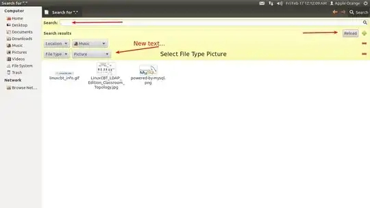

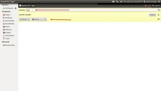

The easiest way (if you are using Ubuntu Desktop):
Go to your Music folder in Nautilus, press Ctrl+F and search for .jpg.
enter image description here & then delete it
You can also change the location and you can make your search more specific.
Updated

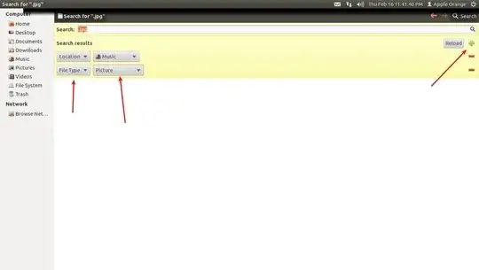

Be More specific after searching .jpg Clicking on green button Select File type Picture & then remove jpg from search only . dot & then reload as shown in pic below
What it does it will search Picture file like .jpg .png .gif & all other file which are in Picture Format
