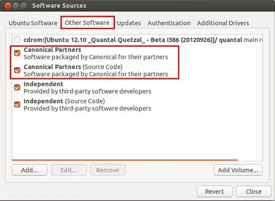

Possibly coming from an upgrade of Ubuntu, a Software source repositories generate an error because it has no entry for the new Ubuntu 18.04
Here is how to fix it
Open the Gnome Software Properties App with App icon or with Alt+F2, type software-properties-gtk, Enter
Then display the Other Software Tab
Find the line(s) related to ppa.launchpad.net/glasen/freetype2/ubuntu
Uncheck the box will disable the software install source
Validate changes and try again with sudo apt-get update
example for window of Software Properties
