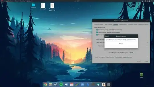

When I hit "Sign In..." on this window to go into my Ubuntu One account, it does nothing. I am expecting a window for my credentials, but nothing happens.

I solved it by going to https://www.ubuntu.com/server/livepatch.
I went to "Generate your credentials" and followed the instructions there.
Then I opened my terminal and typed this two commands:
sudo snap install canonical-livepatch
sudo canonical-livepatch enable [TOKEN]
You get [TOKEN] by following the instructions on "Generate your credentials".
