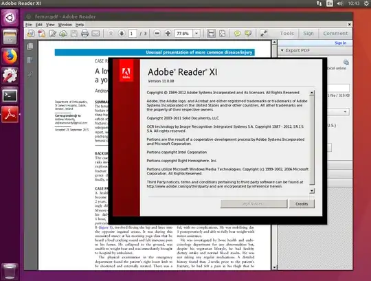

4. Running the reader:
When the reader first loads select the option "Always open with Protected Mode Disabled" seen in the first screen. Then for the most part you should be set although I have not extensively tested all available options.
Below is a screenshot of the Acrobat Reader running on my own 16.04 system:
Adobe Acrobat on Ubuntu Linux

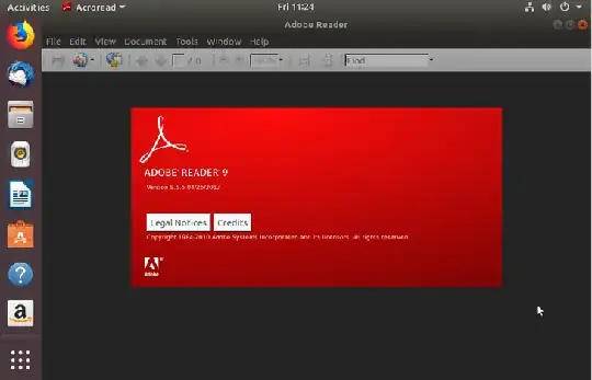

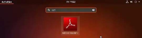

Adobe Acrobat Reader on Ubuntu 18.04 Bionic Beaver
(No wine required)
Install all Prerequisites - Step 1
sudo apt install gdebi-core libxml2:i386 libcanberra-gtk-module:i386 gtk2-engines-murrine:i386 libatk-adaptor:i386
Download Adobe Acrobat Reader - Step 2
wget ftp://ftp.adobe.com/pub/adobe/reader/unix/9.x/9.5.5/enu/AdbeRdr9.5.5-1_i386linux_enu.deb
Install Adobe Acrobat Reader - Step 3
sudo gdebi AdbeRdr9.5.5-1_i386linux_enu.deb
That's it... Enjoy
