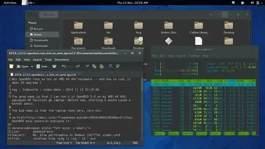

You probably look for the Adwaita-dark theme
gsettings set org.gnome.desktop.interface gtk-theme 'Adwaita-dark'
you will also find a Firefox Extension to make it dark too
https://addons.mozilla.org/en-US/firefox/addon/adwaita-dark/
