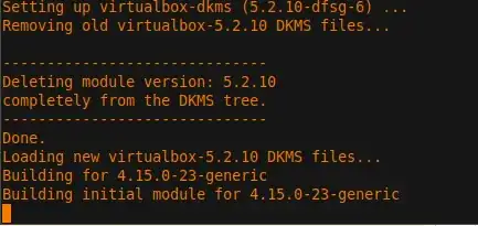

But there still appears to be a residual problem that I can't discontinue. Synaptic still gives me the same prompt if I try to use it. So does dist-upgrade command when I tried it among other things. If I try sudo dpkg --configure -a now I still get a process that appears to freeze in terminal. I get this:
And then nothing more seems to happen. Task manager seems to indicate nothing is happening. I saw that this was addressed once before on this forum but those solutions did not seem to work for me in this case.

The above combination was what worked for me.
sudo rm /var/lib/dpkg/lock
sudo rm /var/lib/apt/lists/lock
sudo rm /var/cache/apt/archives/lock
cd /var/lib/dpkg/updates sudo rm *
sudo apt-get remove virtualbox-dkms
