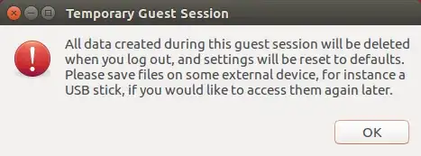

Guest User accounts for 16.04 and prior, are controlled by lightdm.conf.
For a grub2 booters with persistent casper-rw partitions, such as mkusb:
Open casper-rw/upper/etc/lightdm/lightdm.conf and change:
allow-guest=true
Now there will be a Guest account.
For Syslinux booters with persistent casper-rw files such as UNetbootin: First mount the casper-rw file:
sudo mkdir /media/casper
sudo mount -o loop casper-rw /media/casper/
Then edit casper/upper/etc/lightdm/lightdm.conf and change:
allow-guest=true
A guest account will be added to boot options.

Modifying the Guest Account
You may use an existing User Account, or create a new User Account, to use as a Live basis for customizing the Guest Session.
Make a directory for guest session, if one does not already exist:
sudo mkdir /etc/guest-session
Create a symbolic link:
sudo ln -s /home/{NAME} /etc/guest-session/skel
Where {NAME} is the name of the User Account you wish to use as a basis.
Any changes made to the user account will appear in the guest account, wallpaper, installed programs, etc.
Any changes to the guest account will be deleted at end of the session.
